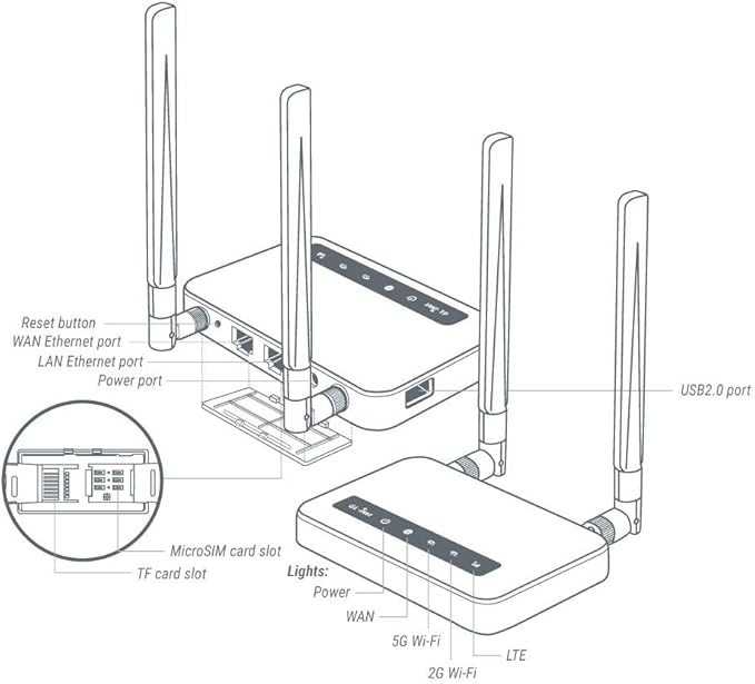

The RV is equipped with a Swiss Army Knife type piece of network gear known as a gateway. It the GL-750V2 Spitz, from GL-iNet, and it is impressive. It’s a router, a firewall, a file server, a WiFi hotspot, a VPN manager, and a LTE-4G Internet modem.
GL-750V2 Spitz on Amazon
You pop a data-only sim card and a micro-sd card in it and you have a network with 24/7 access to the Internet. Using a Cloudflare Tunnel, devices on the network are associated with domain names, i.e., rv.mydomain.com, video.mydomain.com, victron.mydomain.com, jarvis.mydomain.com, etc. Let’s look at the big picture then dive into a few details.

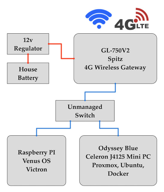

RV Network Diagram
Let’s run through the components:

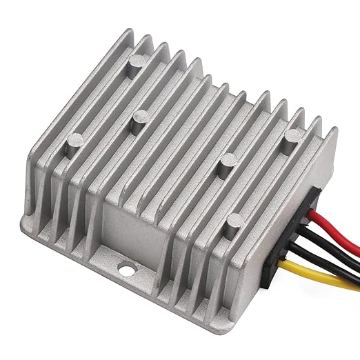

  • The Spitz operates on 12 volts DC and draws less than 6 watts. The battery bank voltage will move around a bit and just to keep things clean, and treat the Spitz with respect, an inexpensive 12 volt regulator will give it nice and even power.
  • The Spitz itself has a radio on the T-Mobile and AT&T network. This is nice given Google Fi operates on those same networks. Depending on where you are, one network might be better then the other.
  • The Spitz is also a Wifi hotspot supporting both 5GHz and 2.4GHz and kind of fancy with guest networks and the works.
  • The Spitz can also take a hardwire WAN feed or repeat another Wifi signal. When the RV is at the house or near good Wifi, it will use the Wifi data before using the 4G LTE Data
  • The Spitz presents a network to it’s LAN port which is connected to an Unmanaged Switch providing more ports to the LAN. This switch is inexpensive and the one we chose operates on 12 volts DC.
  • Next we have the Odyssey Blue Mini PC. This is a very capable but low power Intel Celeron computer with 4 threads, 8 GB RAM and a 2 TB SSD. It runs the Debian Linux based Proxmox virtualization package, ie, computers inside a computer.
    • Ubuntu Server - A headless server to run Docker and Home-Assistant
    • Ubuntu Desktop - a full desktop for display on the RV HDMI monitor
    • More virtualization utilities to follow, identify bird calls, etc.
  • Finally we have a Raspberry PI running Venus OS. This tiny computer is dedicated to communicating and managing the Victron Multiplus II and Solar Charge Controller products.

Total Power Consumption
The selected Buck Boost power converter can deliver 60 watts of 12 volts DC, more than enough power to run the 4G LTE Gateway, the computer, and the switch.
Component Power Consumption
Odyssey X86 Mini PC < 6 watts
Unmanaged Switch < 6 watts
GL-750V2 Spitz < 6 watts
Raspberry Pi 4 < 6.4 watts
12 Volt Buck Boost Power Converter
Even through the RV has a large battery bank, the voltage can vary from 12.5 volts to 12 volts when turning on/off appliances, or when the A/C cycles. The Buck Boost converter will supply a steady 12 volts.
