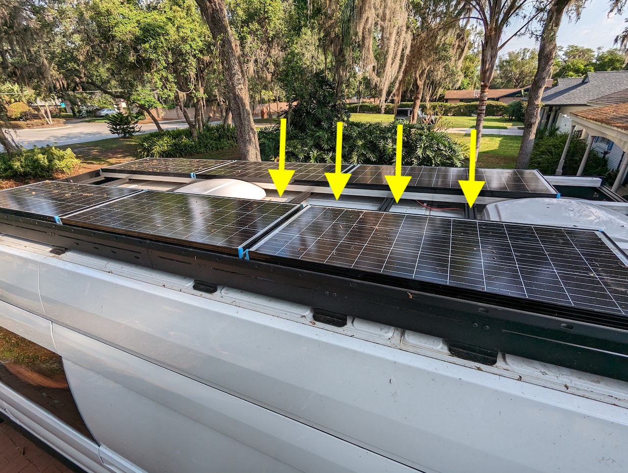

RV Roof Placement
Design Basics
The sub-system, when installed fits perfectly between the two rows of solar panels, and between two cross rails. First make the sub-system rack fit where it needs to be installed, with a little (1/4") leeway. This way you can move it to your workbench while avoiding all the up/down time and travel your RV roof.
