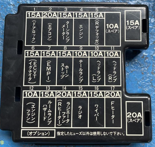

For convenience, here is a translation from Japanese to English on the 1992-1998 Subaru Sambar Fusebox.
Fusebox Japanese to English Translation
| Pos | Value | Name | Japanese Name | Fed from |
| 1 | 15 | Door Lock (Optional) | (ドアロック) | Main Fuse #2 (60A) |
| 2 | 20 | Air Conditioner (Optional) | (エアコン) | Main Fuse #2 (60A) |
| 3 | 15 | Turn Signals, Speedometer | ターンランプ メーター | Main Fuse #2 Via Ignition |
| 4 | 15 | Engine | エンジン | Main Fuse #2 Via Ignition |
| 5 | 15 | Rear Defogger (Vans Only) | (Rデフォッガー) | Main Fuse #2 Via Ignition |
| 6 | 15 | ECVT Relay (EFI/SC eCVT Only) | (ECVT イグナイタ) | Main Fuse #3 (30A) |
| 7 | 15 | Engine Computer (EFI/SC Only) | (EMPI) | Main Fuse #3 (30A) |
| 8 | 15 | Horn, Brake Lights | ホーン ストップ | Main Fuse #1 (30 or 40A) |
| 9 | 10 | Tail Lamp | テールランプ | Main Fuse #1 (30 or 40A) |
| 10 | 10 | Headlamp L | ヘッドランプ (L) | Main Fuse #1 (30 or 40A) |
| 11 | 10 | Headlamp R | ヘッドランプ (R) | Main Fuse #1 (30 or 40A) |
| 12 | 10 | Engine Fan (SC Only) | (エンジン ファン) | Main Fuse #2 (60A) |
| 13 | 15 | Room Lamp/Hazard Flashers | ルームランプ ハザード | Main Fuse #2 (60A) |
| 14 | 20 | Radiator Fan, Rear Heater (Opt) | ラジエータ ファン (Rヒーター) | Main Fuse #2 (60A) |
| 15 | 15 | Radio | ラジオ | Main Fuse #2 Via Accessory |
| 16 | 15 | Wiper | ワイパー | Main Fuse #2 Via Accessory |
| 17 | 20 | Front Heater | Fヒーター | Main Fuse #2 Via Accessory |
Fusebox Image
Subaru Sambar 1992-1998 Fusebox
