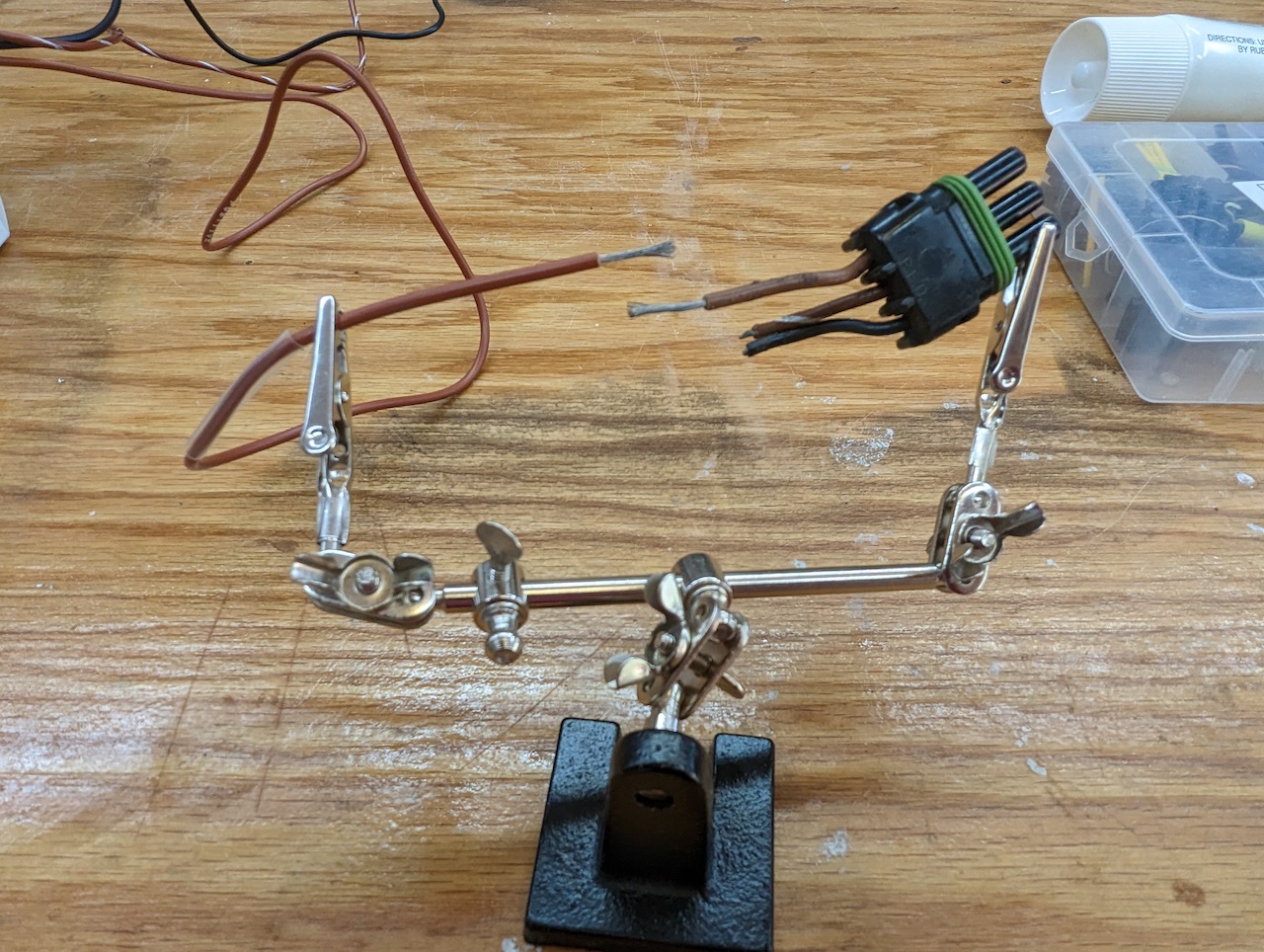

In this example, I’ll walk through how I would solder wires for use in a wet
environment. To get started I have stripped about half an inch of wire from
each of the brown wires. The Klien wire strippers are the best and mechanically
one of the most interesting tools that I own.
The Helping Hands are used to hold wires in place. I’ve used larger versions
of this type of helper device, but I have found I only need two extra hands.
You can spend a lot more but this is all you will need.
Helping Hands are a big help for more complicated tasks

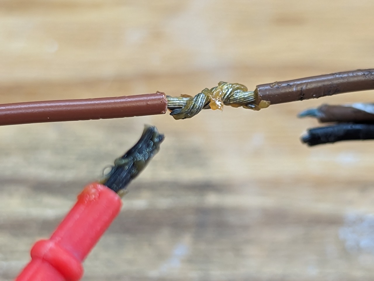

Next you twist the wires together, without making any lumps, get has much
contact between the two wires as possible. Make sure no wire ends are sticking
out, they can puncture the shrink wrap installed later
Now apply Rosin Soldering Flux to make the next step easier.

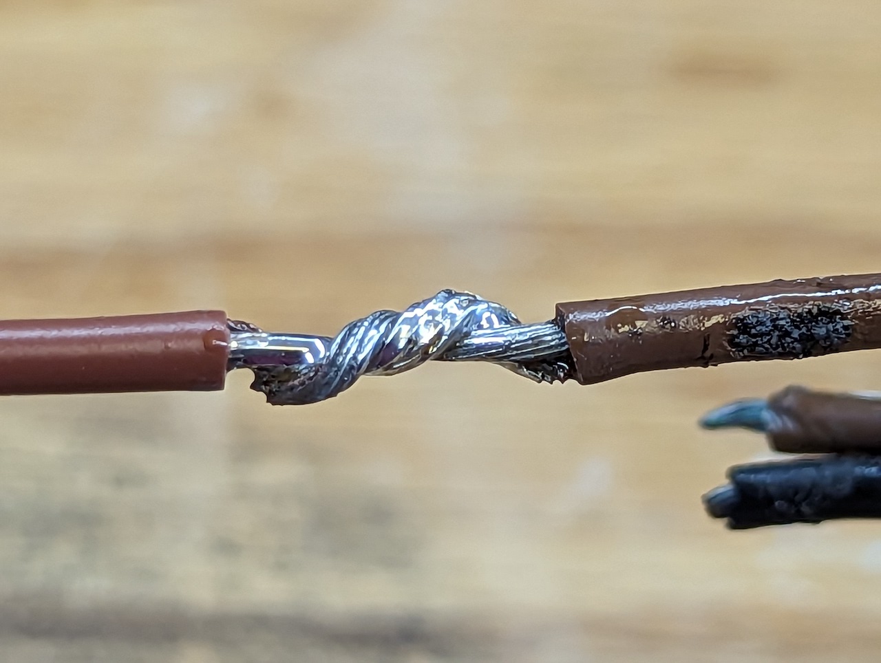

I solder the wire using lead solder and a
[butane soldering iron](#butane soldering iron). You can see in the picture that
the wire casing is a bit charred but that was not by me, this wire was used in
a rather harsh environment. I think it was riding on an exhaust pipe for a while.
I’ll cover most of the char with shrink wrap.

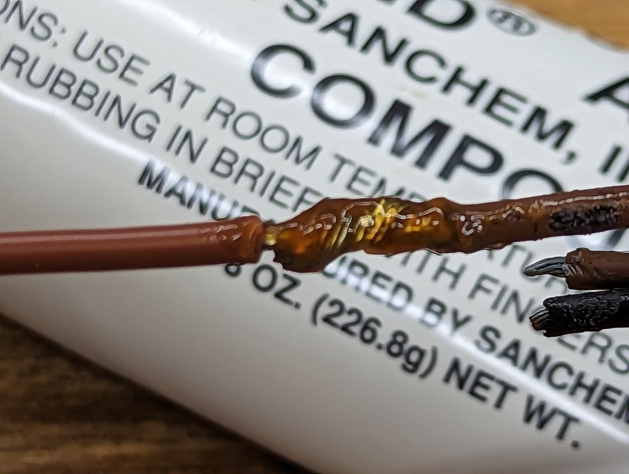

Next I protect the exposed wire with No-OX-ID special grease
This improves conductivity and protects the wire from exposure to water and humidity.

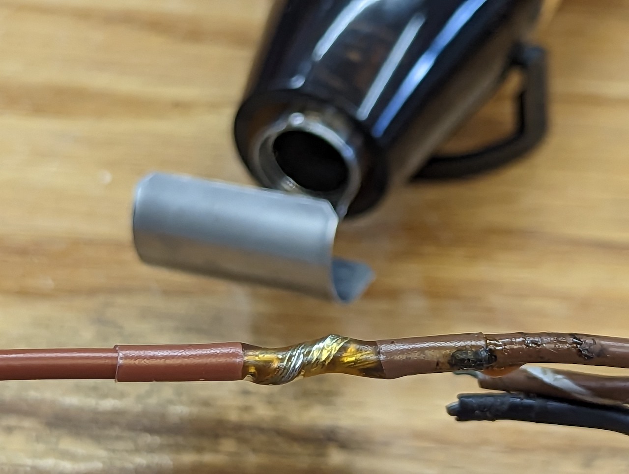

Finally I slide the heat shrink over the soldered wire and
apply heat with a heat gun. Note how well the clear shrink tube
shows the grease protecting the solder joint. Unless you are showing polarity with
red or black shrink tube, or need some other color scheme, use clear tubing.
