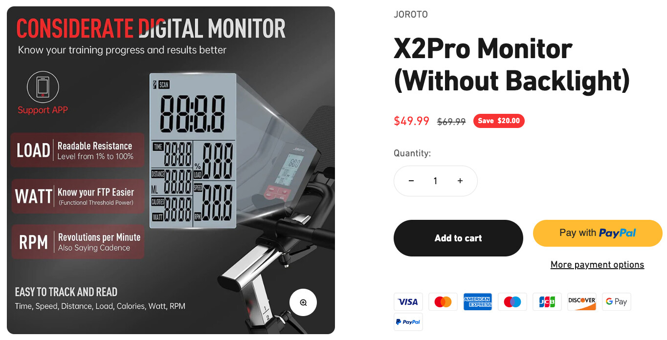

Alternate bike computer, will it work?
https://jorotofitness.com/products/x2pro-monitor
