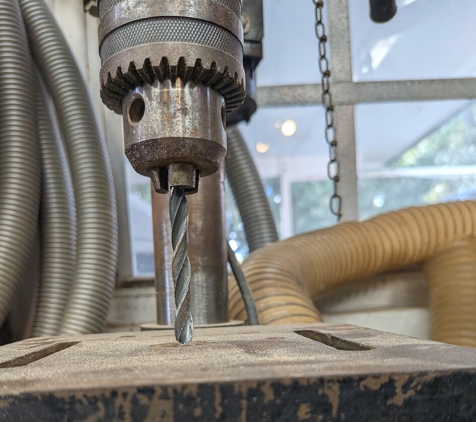

First, set your drill press depth to z = 0, such that the drill-bit tip just touches (or is ever so slightly above) the shelf surface. We’re going to drill each drive from the bottom and fill the air-tight drive volume with epoxy.

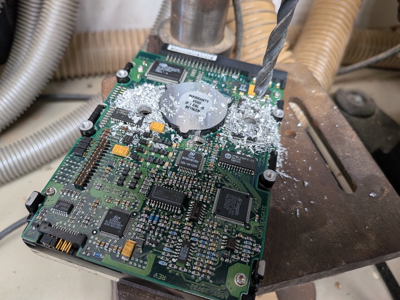

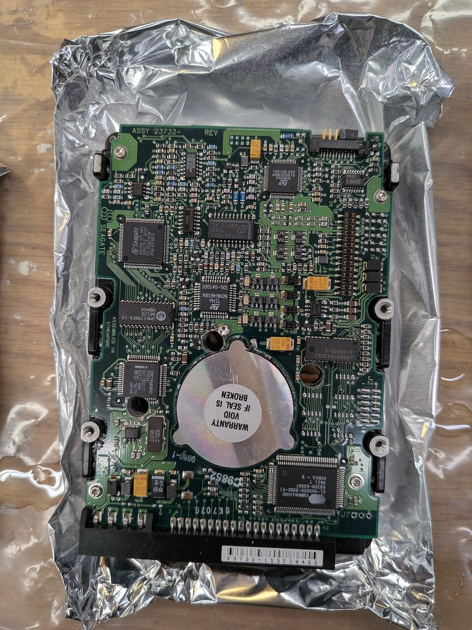

Using a ~¼″ drill bit, make three holes in each drive. Distribute the holes from the center toward the edge and on different sides of the drive. Try to remove the actuator mechanism if possible.
It’s satisfying to feel the drill-bit pass through each of the platters. The days of rotating magnetic storage have nearly passed.

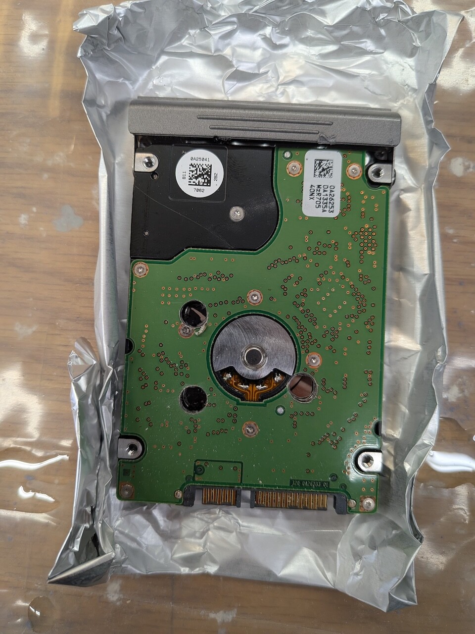

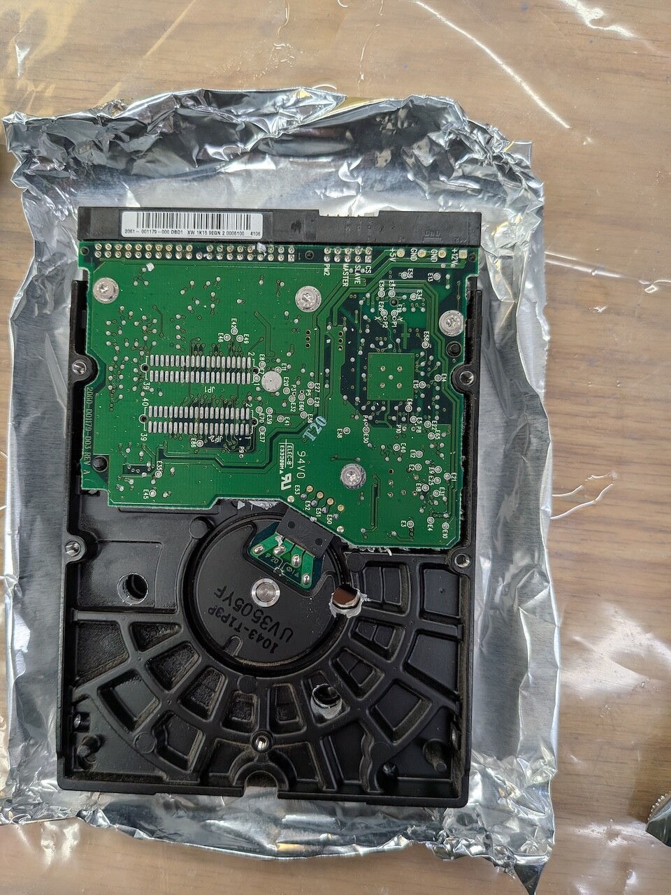

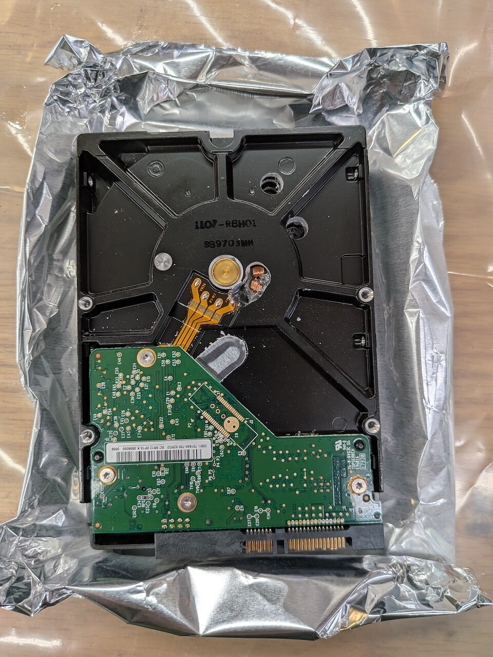

Place each drive in a container to catch any spilled epoxy — I used aluminum foil. Note: one of these drives is from a Dell laptop, and the drive with the full-sized printed circuit board is a dead 2TB backup drive.
