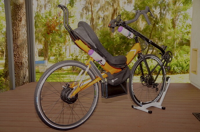

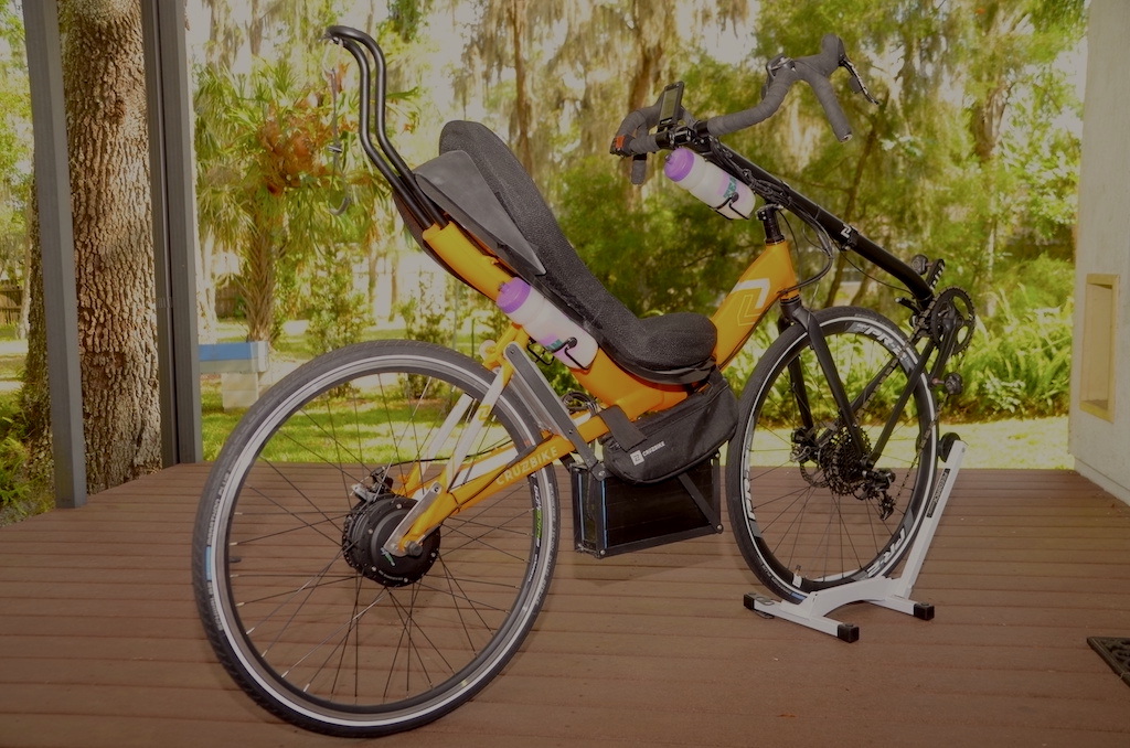

Overview Cruzbike S40 Ebike
The Cruzbike S40 Ebike is built on the Cruzbike S40 frame, a short-wheelbase high riding recumbent, a 500 watt (peak 1056 watt) motor, a 48 volt 20.8 Ah battery, disc brakes, SRAM components, Schwalbe Marathon Plus tires with custom battery bracket, custom controller bracket, and a custom torq arm. The bike is 2-wheel drive, the front wheel human is powered and the rear wheel is motorized. It was designed specifically for the Horrible Hundred bike event in Clermont Florida. If Florida was a pancake, the Horrible Hundred crosses over about 20 large blueberries.

Components & Specifications
Frame | Cruzbike S40 Frame
Ebike Kit | 36V 500W GEARED EBIKE CONVERSION KITS
Accessory stub | Origin 8 Perfect place for a light or camera
Battery | LG Li-ion 48V, 20.8 Ah
Battery cradle | Custom aluminum
Bottom bracket | SRAM Bottom Bracket GPX Team 73/68
Brake lever - left | SRAM Apex 1 Left Break Lever
Brake lever - right | SRAM Apex 1 Double Tap Right Break Lever
Brake set | TRP Spyre Allow Mechanical Brake Set
Cassette | SRAM Nx Pg-1130 11-42 Speed Cassette
Chain | SRAM PCX1 11 Speed Chain
Controller bracket | Custom aluminum
Crankset | SRAM Apex 1 Crankset
Kill switch | It’s big and red, and accessible
Motor | 36V 500W rear hub brushless motor
Rear derailleur | SRAM Apex 1x11 Long Cage Rear Derailleur
Sling Pack | Carry tools, tubes, cell phone, snacks, etc.
Thumb throttle | Custom thumb throttle bracket
Torq arm | Custom aluminum
Weight | 54.2 lbs, 24.5 kg, with full complement of tubes, tools and bottles

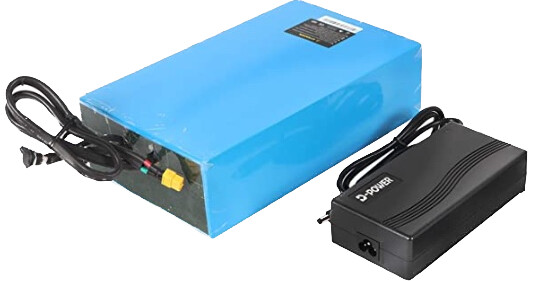

LG Bare Cell Battery
Loaded with capability, 998 watt hours at 48 volts, the battery also has significant
liabilities. It is massively heavy at 11.3 lbs, more than
half the weight of common road bikes made today.
Not only is it big, it is expensive. It cost more than the ebike conversion kit.
In the flatlands of Florida, the biggest factor is not weight
but is aerodynamics, followed by rolling resistance.
Just the same, the bike and rider will be challenged to complete
the Horrible 100 including its
1377 feet
of elevation change.
48V 20.8AH RECTANGULAR BARE LG CELL BATTERY
- Li-ion Battery pack is made of 2900mAh LG Cells
- Combination 13S8P
- Charge Limited Voltage 54.6V
- Discharge Limited Voltage 39V
- Charge current 2A
- Charging Mode CC/AC
- AC Input 100-240V 50/60 Hz
- Cycle Life 1000 cycles
- Charging Time 4.5 hours
- Battery 11.3 lbs, 5.13 kg

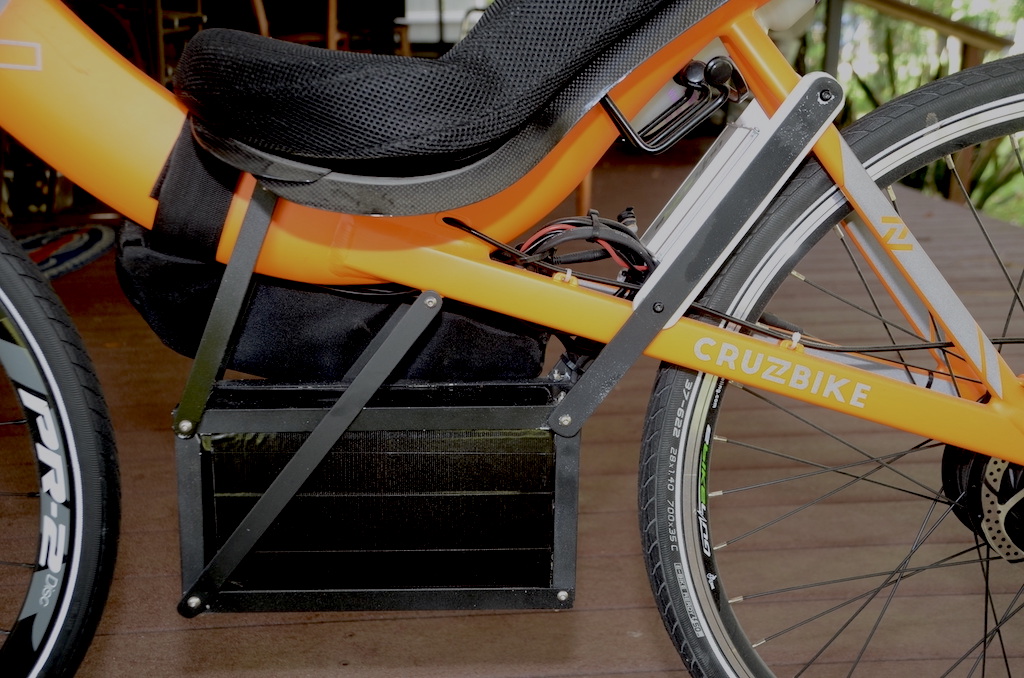

The location and construction of the battery bracket was a major design focus.
The concern was that over time the aluminum attachments would fail due to the
weight and shock of a heavy battery relentlessly pulling on the bike frame.
The design has a rectangular bracket enclosing the battery and six separate
attachment points to the frame to distribute the load.
The main attachment point shares the attachments with the controller.
This bracket provides both vertical support and horizontal support to keep
the battery from swaying front to back and side to side.

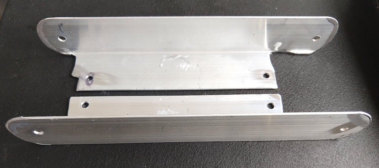

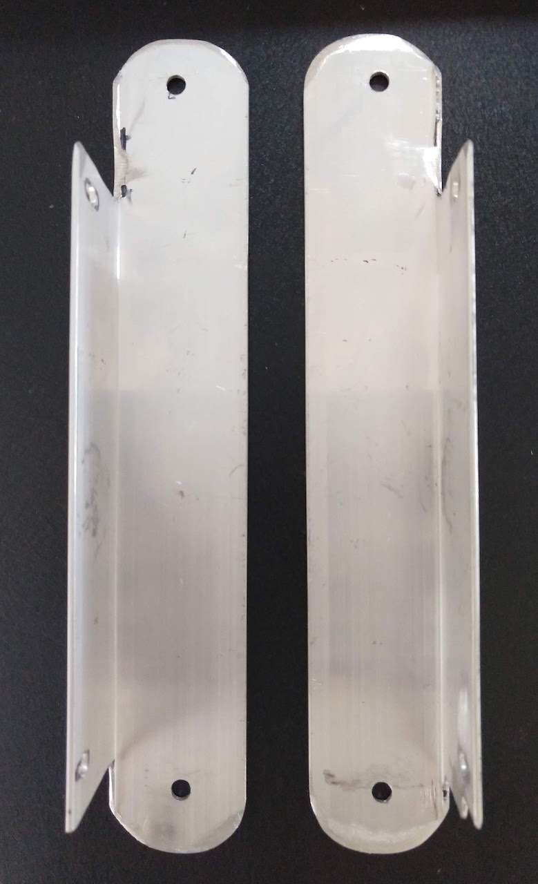

Controller & Custom Bracket

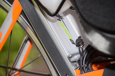

The controller is fairly light weight requiring only a modest bracket design
to secure it in place. The bracket uses a pair of aluminum L-channels;
The motor cable was just long enough to fit in a natural place without the need for an extension cable.
Note the covered plug, this is how you charge the battery. The kit comes with a
brick style battery charger.

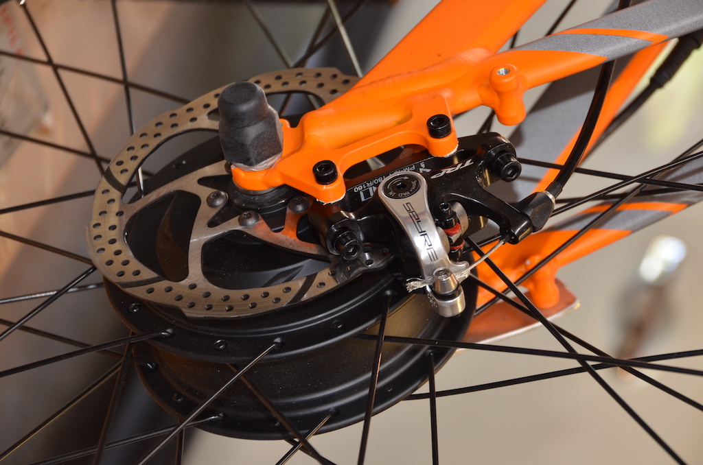

500 Watt Geared Motor & Torq Arm
Given the bike is built for endurance and comfort, the selection of a 500 watt motor
fits the bill. See the section The section About Power covers the
topic in detail, but know the subject can get complex. A 36 volt motor 500 watt motor
that is powered by a 48 volt battery will generate more than 500 watts of power.

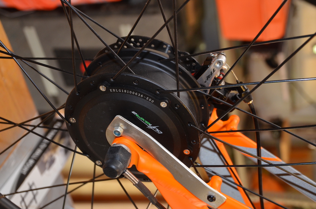

Note the custom torq arm. The kit came with a short stainless steel torq arm and
a band clamp. I figured the band clamp would scratch the paint so I fabricated
an aluminum torq arm that bolts nicely into the chainstay islet.

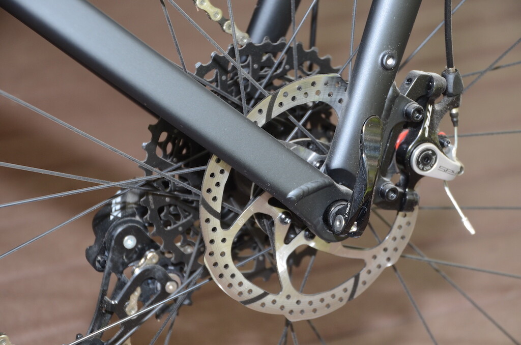

TRP Spyre Alloy Mechanical Road Disc Brakes
These are nice low-maintenance brakes. The large 160 mm rotors give the brakes the leverage they
need to stop quickly with even control.

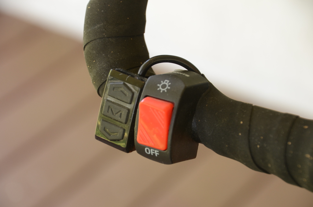

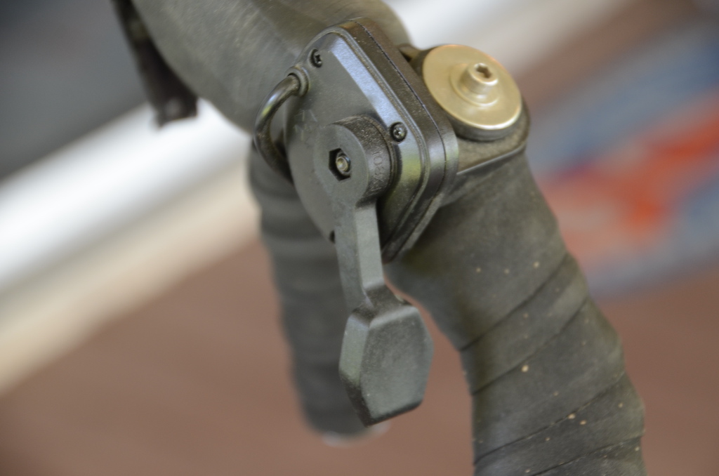

Additional Handlebar Controls
The 3-button switch controls the bike on-off state, sets different pedal-assist modes
and allows user configuration of the motor controller. See the second on
S830LCD Display & Configuration for details.
User can operate the thumb throttle with both hands or just just
the right hand, while maintaining access to one or both brake levers.

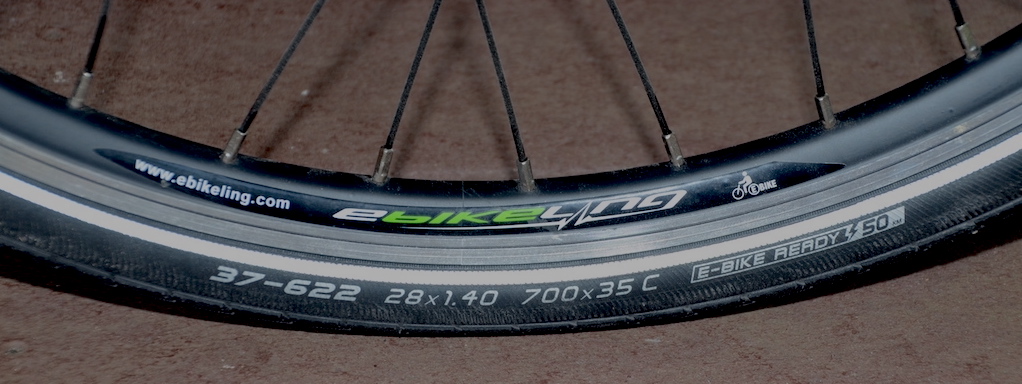

After some assessment, I chose to use Schwalbe Marathon Plus tires in a 700x35c size.
| Wheel | Inside Width | Outside Width |
| Front | 17.4 mm | 23.2 mm |
| Rear | 18.8 mm | 24.8 mm |
I wanted a larger tire to provide a smoother ride and chose durability over speed,
i.e, to have a heavier tire with thicker tread over a lighter tread with thinner tread.
The table above is with tires inflated to 60 PSI. When inflating tires to 90 PSI the
difference between the Parathon Plus and tires about half this weight is a little
more than 2 watts. For me, the additional durability was worth the 2 extra watts
required to move down the road.

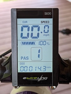

S830 LCD Display & Configuration
The eBike controller is configured from the S830 LCD display.
Enter settings mode
* Power up the unit using a long press on the center button.
* Long press up and down buttons to change a parameter value and advance
to the next parameter.
* Use the center button to advance to the next parameter.
To edit parameter P03.
1. Long press the center button to power up the unit.
2. Long press the up and down buttons to enter settings mode.
3. Shrt press the center button twice to advance to P03.
4. Short press the up and down buttons to change the parameter.
5. Short press the center button to save changed parameter.
| Parameter | Value | Description |
| P01: | 3 | Backlight Brightness (1: darkest; 3: brightest) |
| P02: | 1 | Mileage Unit (0: KM; 1: MILE) |
| P03: | 36 | Voltage Class: 24V /36V / 48V |
| P04: | 10 | Hibernation Time (0: never, other figures refer to the hibernation time), Unit: Minute |
| P05: | 1 09 | Power Gear – 0/3 Gear Mode: Gear, 1/5 Gear Mode: Gear, P05 means how many assist grades you want from the motor. |
| P06: | 29.0 | Wheel Diameter Unit: inch Precision: 0.1 |
| P07: | 86 | Magnet Steel Number for Speed Test Range: 1-100, Set magnet number P07 to 47 if it’s direct drive motor and if the motor is geared then it should be set to 86. |
| P08: | 50 | Speed Limit Range: 0-50km/h, parameter 50 indicates no speed limit. |
| P09: | 1 | Zero / Non-zero Start Setting: 0: Zero Start, 1: Non-zero Start |
| P10: | 2 | Drive Mode: 0 Pedal Assist only, 1 Throttle only, 2 Pedal Assist and Throttle |
| P11: | 2 | Uncertain. If you know what this does let me know. |
| P12: | 3 | Assist Power Intensity Range: 0-5, P12 means pedal assist sensitivity, from 0 to 5 shows how sensitive you want your pedal assist. |
| P13: | 8 | Power Magnet Steel Number. For eBikeling set it to 8. |
| P16: | 8 | ODO Zero-Out: Long press the upper key for 5 seconds and ODO will zero out. |
This Bike is For Sale
It has been a fun project but is time to clear out the barn a bit and make room
for future projects. I have four other bikes and can only ride one at a time.
Important Disclaimer: This Bike May Not Be for Everyone
Please read this before proceeding. Riding a motorized front-wheel-drive (FWD) recumbent bike like the Cruzbike is a unique experience that differs significantly from traditional upright bikes or even rear-wheel-drive recumbents.
- Experience Recommended: Prior time on a recumbent bike is highly beneficial. The FWD design requires adapting to different handling, balance, and steering dynamics—especially at higher speeds or with motor assistance.
- Motorized Aspects: The electric motor adds power, speed, and complexity. It demands familiarity with e-bike controls, battery management, and safe operation to avoid accidents.
- Safety First: Always wear appropriate protective gear, start in a safe environment, and consider professional instruction if you’re new to this style. Test rides are strongly encouraged.
If you’re unsure about your ability to handle this bike, we recommend consulting with experienced riders or opting for a different model.
If you already have experience with a Cruzbike then you are good to go,
but if not there is a learning curve to a front wheel drive bike.
Some new riders get the hang of it in 15 minutes while other riders may need to
experience as many as 100 miles before feeling totally comfortable.
The price for this bike is $5,650.00. This works out to the current cost of a
Cruzbike S40 at $4,650, plus $1,000.00 for the ebike upgrade kit, plus a few parts.
And you get my design and labor for free.
Yes, even today these batteries are still over $500 and the Ebikeling kit is $399.
So how would buying this bike work? There are a couple of options. If you are in the Central Florida area, contact me and we can make arrangements for your to see it and ride it. Like Disney, Universal Studios or Kennedy Space Center? This is not too far and you would have another excuse to travel this way.
For payment, I can provide you with PayPal information, a Bitcoin or Etherium public key, or you could snailmail me a check and we can wait for it to clear before moving ahead.
If you are not in Central Florida then you could arrange for an inspection with a bike shop. We could also talk via Zoom, phone or some other way.
As for shipping, it will be between you and a bike shop and a shipper. We can pick a bike shop of your choosing, and for a small fee they will box the bike for you and you can schedule shipping with a company like Bike Flights. I have used them a couple of times and they are cost effective with good service.
Contact me, thanks! [email protected]
