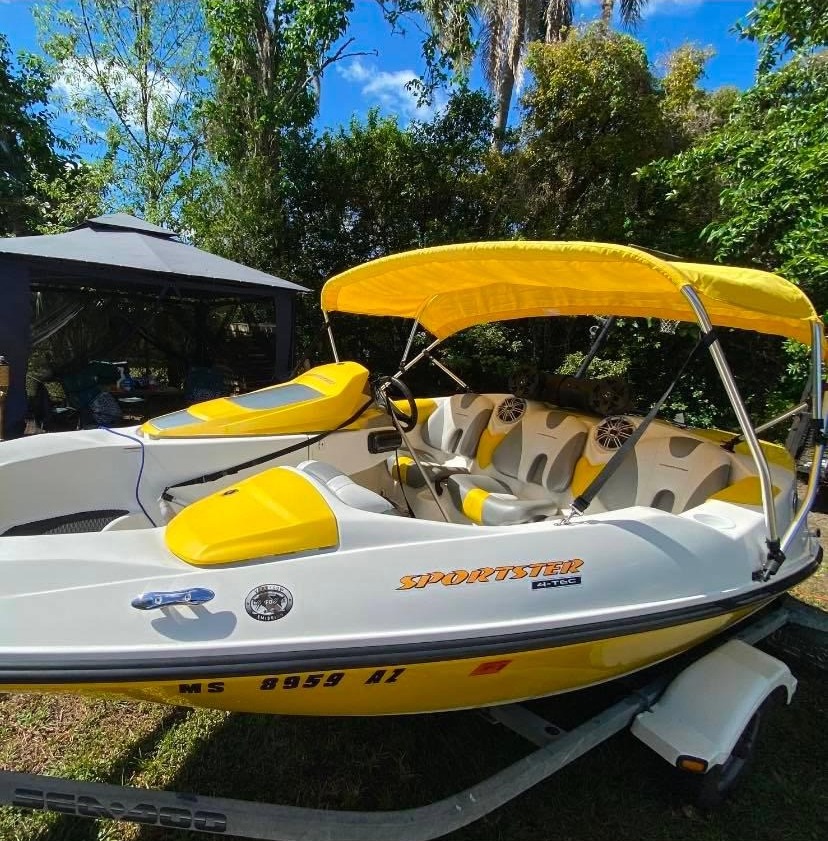

2003 Seadoo Sportster Rehab
I recently acquired a 2003 Sea-Doo Sportster 4-tec and discovered that the oil has a milky, chocolate milk-like appearance. Initially, we suspected that lake water might have mixed with the oil. However, upon further investigation, we found out that it’s actually radiator fluid causing the discoloration.

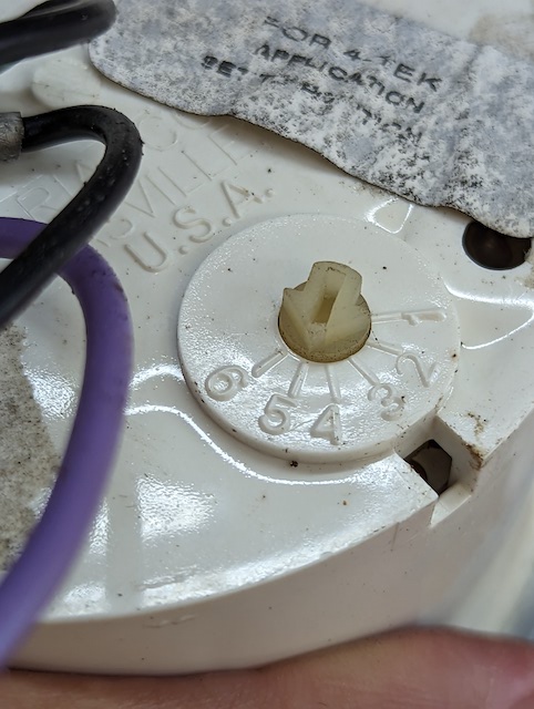

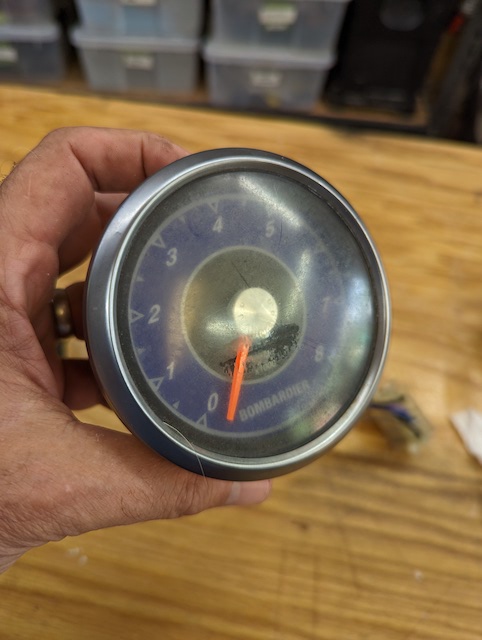

June 23 - Tachometer Inspection

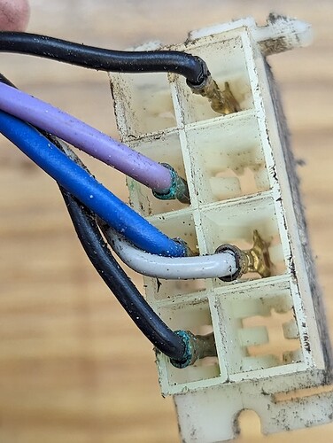

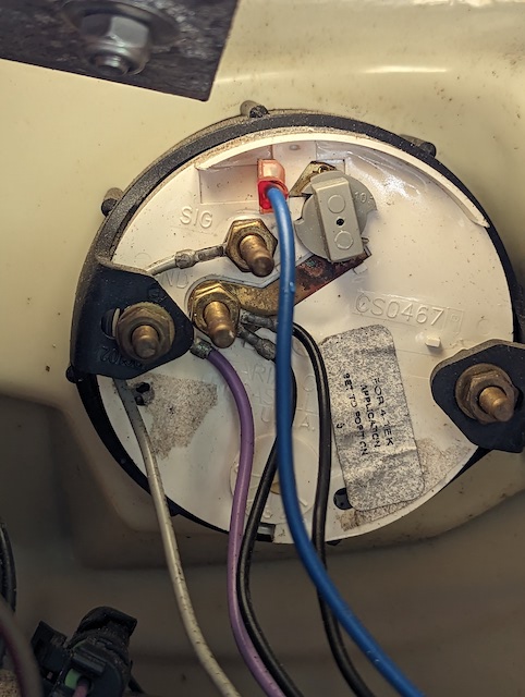

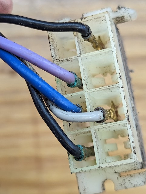

Update: I’ve made some progress. The gauge was simple to remove, no tools needed. I found minor corrosion on a few contacts, but it wasn’t a major issue. After cleaning and spraying the electrical connections, I tested each for continuity with a meter and they all checked out fine. The light bulb was faulty, so I’ve ordered a new one from Amazon for $4. However, despite these steps, the tachometer still isn’t working after I powered up the system.
Can anyone suggest where I might find a reasonably priced replacement tachometer? I’ve seen one for $250 on a website, but I can’t justify spending that much.
This was before I polished it, it looks much better
I’m not excited to see the green, but electrically all the connections are fine
Replacement tachometer bulb
Good stuff for cleaning electrical contacts

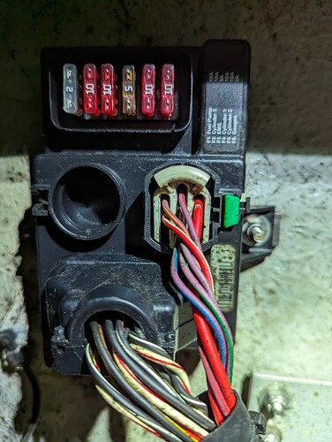

  7. Checked all the fuses, replaced the blown bilge fan fuse

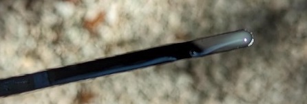

I found milky oil on the dipstick
This is what I have done so far. I first changed the oil and filter, let it run for about 2 minutes (turn water on after engine start, turn water off before engine stop), and the oil color seemed a little better. So I did two more oil changes, now a total of three, and each time it has improved the oil color over the last. Now it looks like skim milk in hot tea, although thick like oil.
Should I keep going with more oil changes? Oil floats on top of water, would there be a pocket of water in the bottom of the engine? Each oil change is about 2.3 quarts and I am reading that the oil capacity is closer to 3 quarts. I am using the dipstick straw to remove oil.

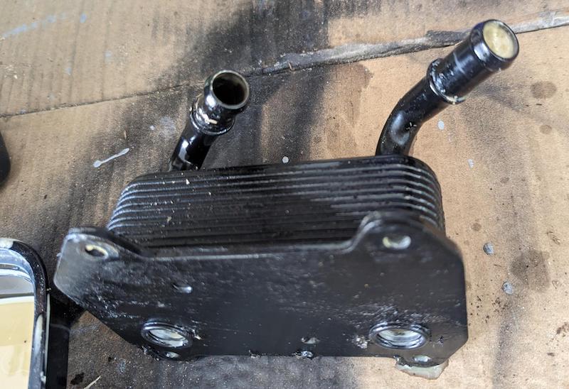

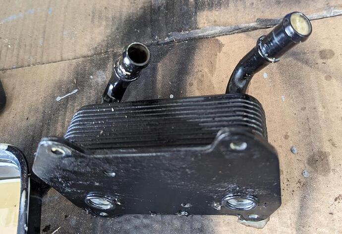

Oil-Cooler: One Side Plugged
My response to the SeaDooForum:
Got the oil cooler out and it’s probably not good news. The input radiator fluid line (see photo) was clogged, with thick milkshake oil. The input rubber hose had the same thick stuff. The output line had oily fluid but not so thick. Not only is there radiator fluid in the oil system but there is oil in the radiator system.
After cleaning it up a bit I hit the radiator side with a little compressed air. After a few seconds, the plug released and the system cleared. Next, I put mild pressure on the radiator side, and it holds air. I could not hear or detect any leakage from the radiator side to the oil side of the cooler.
I’m thinking the oil cooler is not the problem. If it clogged on the radiator fluid side, and the fluid was under pressure, the fluid would find the next weakest point to escape and perhaps through a gasket into the engine? Head gasket? Why would it clog in the first place?
Options?
a) I could clean everything, put it together, add oil and radiator fluid and try it.
b) Remove the head, inspect the engine, and replace the head gasket.
Option a, I can do, but I would probably find a shop to help with option b.
Thoughts appreciated
The oil radiator (oil cooler) was entirely plugged on the input side

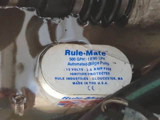

Rule-Mate 500 Bilge Pump Failure
The bilge pump was probably original, although soldered wire under electrical
tape does not seem to to be a factory installation. This pump has 3 wires.
Pumps with 2 wires only support manual operation.
Color Function
Black Ground
Brown Manual on/off
Brown/White Automatic on/off
The pump was dead and did not respond to 12 volts. Nice looking bilge water eh?
It’s not really as bad as it looks, you are seeing the reflection of the wite ceiling.
This Rule-Mate 500 bilge pump had failed

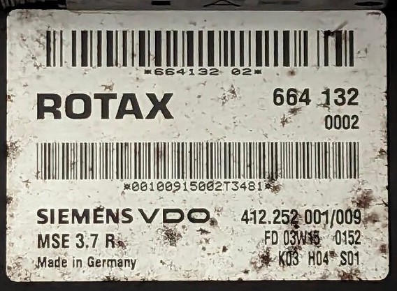

Emmission control information
Rotax engine sticker, Made In Germany!

Engine fuse box

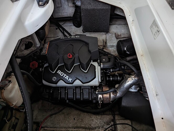

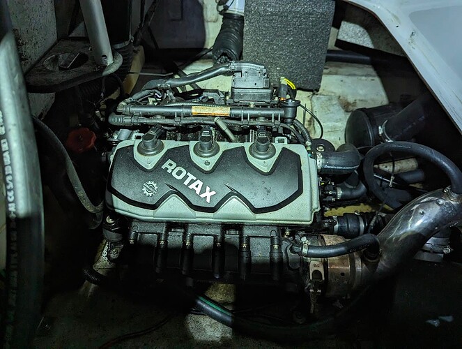

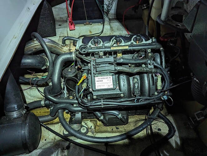

Engine from port side, cover off
Engine from port side, cover on, all the room!
Engine from starbord side

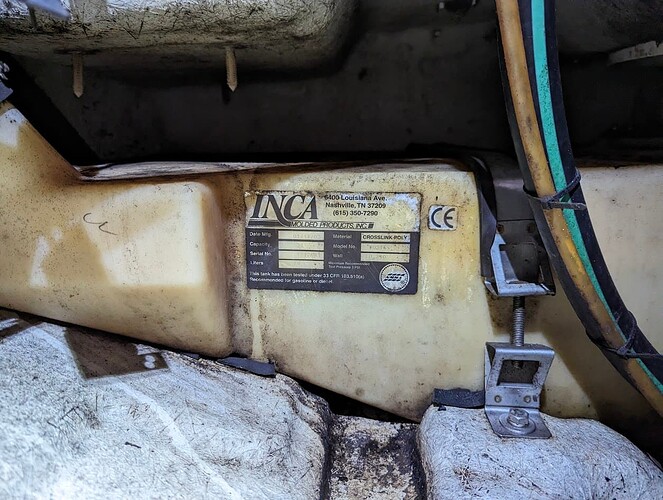

Engine gas tank

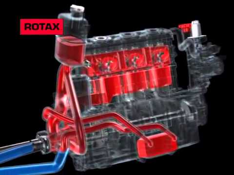

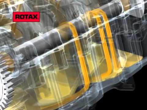

Rotax YouTube
How to detected a leak in a Seadoo 4-tec oil cooler
Seadoo 4-tec oil system
Seadoo 4-tec cooling system
