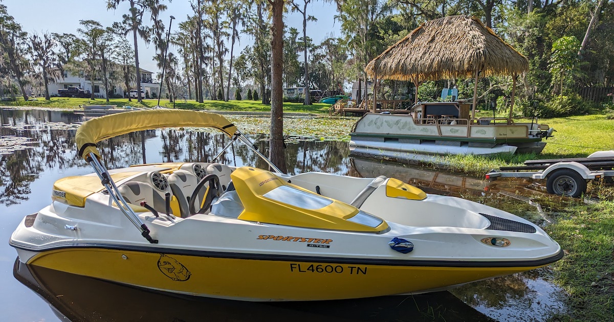

New to me, I’ve got a 2003 Sea-Doo Sportster 4-tec. These are fun little boats,
although some specific Sportster parts are difficult to find, i.e., electronics,
the 4-tec is still popular today and used in many jet skis and boats.

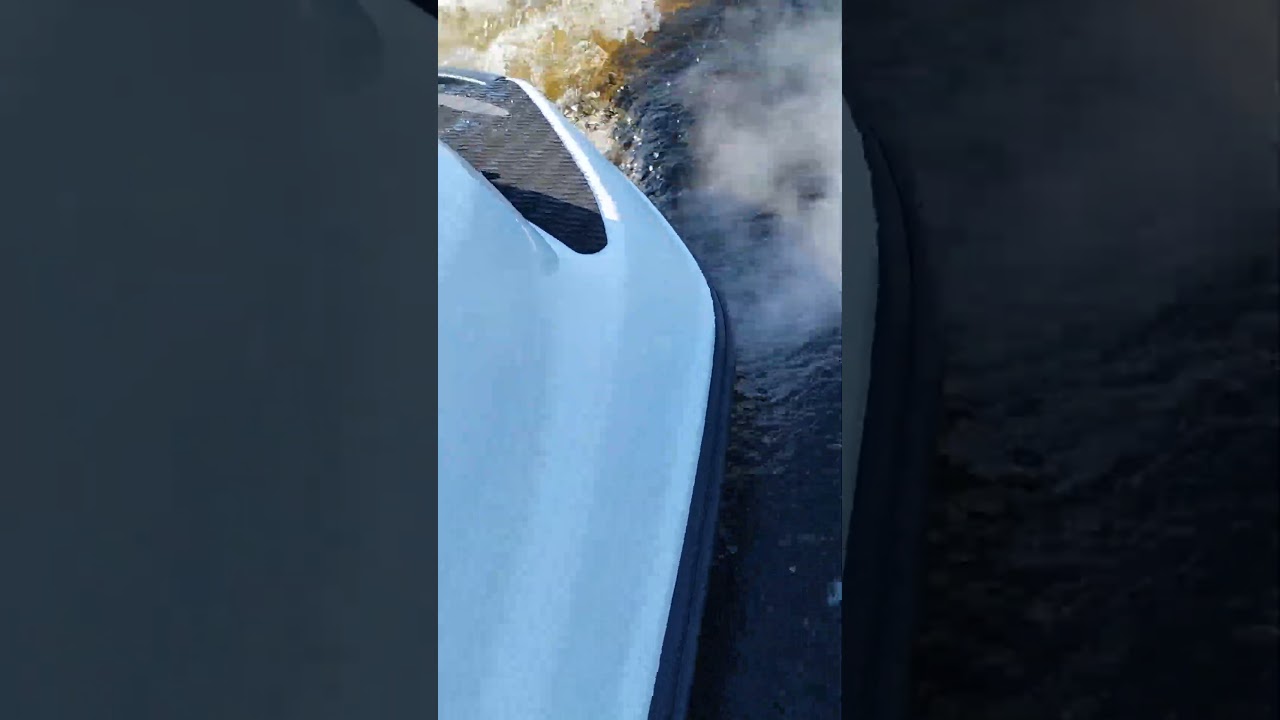

Then there is the white smoke business. Is it oil based smoke? or water vapor?
Is the radiator fluid getting atomized into smoke?

We took it out for a test run yesterday. It started up, and ran rough at first
but smoothed out somewhat over time. There was a little white smoke at first but
that stopped after the first couple of minutes.
